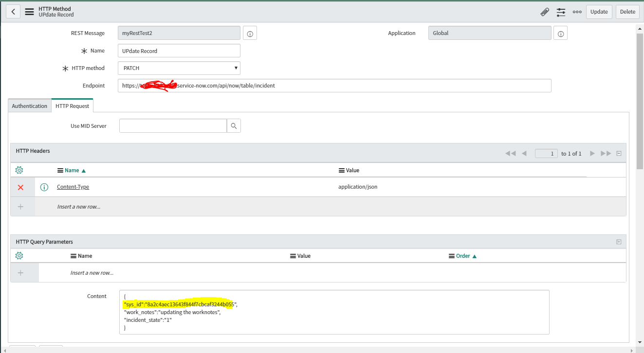

I have a RET API for an Service NOw instance. with that i am able to get/create records in incident table but I am not able to update incident using sysid.
any ideas ????
I have tried both put and patch method but none is working.. getting below errors :-
{"error":{"message":"Method not Supported","detail":"PATCH method not supported for API"},"status":"failure"}
{"error":{"detail":"PUT method not supported for API","message":"Method not Supported"},"status":"failure"}

why dont you use put method here and pass the sysid in the end point url so that the record will get updated on respective record only
Hello Harshvardhan, i have tried PUT too. it is not working.
it should work for both , now the question i have, how are you identifying which record should update ?
if i see the end point you simply passed the url , but which record it should update those values ?

on instance a i have create one incident inc10020 now i want to update that incident
so in the endpoint url , you have to mention the incident  number or sys id so that the method will update on the respective inc10020 columns only.
https://developer.servicenow.com/app.do#!/document/content/app_store_doc_outbound_rest_helsinki_t_Co...
The endpoint for Put method should look like below. You have to pass the sys_id in the URL.
PUT https://xxxxxx.service-now.com/api/now/table/{tableName}/{sys_id}
