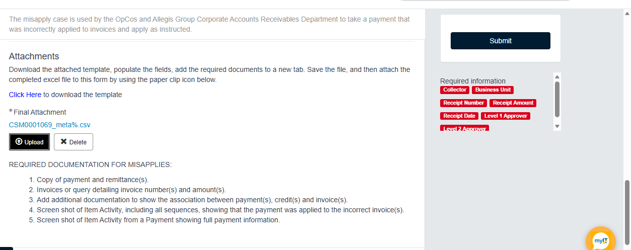

Hi @Sarthak Kashyap
Thanks for your response. I checked your solution, but it is still not working for me. The system is still allowing files with special characters in the name to be attached. Please check the attached screenshot.
FYI, I have also used the variable attribute 'allowed_extensions=csv' for this attachment type variable.
Please check the below client script:
        return;
    alert("Called = " + g_form.getValue('final_attachment'));
    var attachmentWidget = g_form.getControl('final_attachment');
    alert("attachmentWidget = " + JSON.stringify(attachmentWidget));
    var fileName = attachmentWidget.displayValue();
    var invalidChars = /[%$@()&<>'"]/;
    if (invalidChars.test(fileName)) {
        alert("Your file name have invalid characters please remove and add");
        g_form.clearValue("final_attachment");
        return false;

@Ankur Bawiskar
When I am uploading the attachment in the attachment type variable, I am getting the below error.
