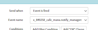

Hello Mohith,
Thank you for your patience, I am learning a lot. Just a couple more things.
First things first, just for confirmation, here are all the configs:
Event registry info:
Scheduled job script:
Notification:
I have set up the things you have mentioned. How may I test this out to see if it works in simulation by impersonating the user with the role?
Thank you
~Mel
@John Clyde Ap[as CHANGE THE EVENT NAME IN YOUR NOTIFICATION  IN EVENT FIELD AND REST EVERY THING IS FINE
Also for testing go to your scheduled job and on the top right corner you can see Execute now button click on it and you will see the result in emails table
Hello Mohith,
Here it is now.
I have confirmed that is it indeed there now.
