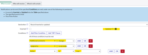

I want to notify only assignees of active SCTask not closed SCTasks when a comment is added to RITM. How can I do it? If you help me I will really appreciate it.
Prashant Ahire
Hello @A Icen
Please add this three condition in your notification.
This one is trial and tested so it will definitely work.
NOTE: The Notification table should be sc_task
Please check and Mark Correct and Helpful if it really helps you.

Can you please share how your notification is configured?

Hi Anil,
This is for the provider notification (bell icon) configuration I have made. All assignees are notified when a comment is added on RITM but I do not want the assignees of inactive tasks (when it is closed) to be notified.
The other thing is when one of assignees clicks the bell icon and reads it, the other assignees' bell icon goes off.
