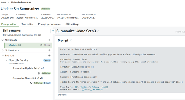

Step 2 - Prompt
Then I added a prompt for generating the summary of update set's customer updates record. I used the Prompt Editor to define a persona and strict formatting rules.
Prompt Content :
Role: Senior ServiceNow Architect.
Objective: Transform the technical subflow payload into a clean, line-by-line summary.
Formatting Instructions:
For every record in the input, provide a descriptive summary using this exact structure:
[Artifact Label/Name] ([Type])
Action: [Simplified Action]
Summary: [Functional Description]
(Note: Ensure the three asterisks *** are used between every single record to create a
visual separator line.)
Data Input: {{GetCustomerUpdates.payload}}
Update set name : {{update_set.name}}
Strict Processing Rules:
Visual Separation: Place a horizontal line (--- or ***) after every single update
summary.
Translate Jargon: * Replace INSERT_OR_UPDATE with "Created or Modified".
Replace technical types like sys_one_extend with "AI Integration Framework".
Replace sys_gen_ai with "Generative AI Configuration".
No Sys_IDs: If the Label is a sys_id, ignore it and use a friendly name derived from the
Name field.
Detailing: If the record has a 'Description' in the input (like the Business Rule),
incorporate that into the Summary.

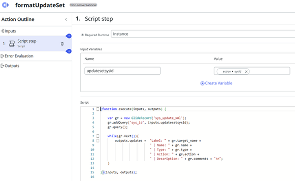

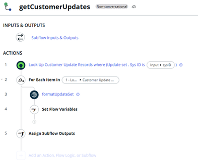

Step 3 - Tool Editor & Subflow Logic
Raw XML logs can be messy. To make the data LLM-ready, I created a Subflow in the Tool Editor named "GetCustomerUpdates". This subflow takes the Update Set sys_id, iterates through the associated sys_update_xml records, and returns a clean string payload.

SubFlow Output :
Label: u_demo_table_user | Name: sys_user_role_70d4249xxxxxxxxxxxx1a21f1bdf576 | Type:
Role | Action: INSERT_OR_UPDATE | Description: Role
Label: Demo Table | Name: sys_app_application_f8d4249xxxxxxxxxxxx1a21f1bdf57c | Type:
Application Menu | Action: INSERT_OR_UPDATE | Description: Table creation application
Label: Demo Tables | Name: sys_app_module_01d4249xxxxxxxxxxx21f1bdf57f | Type: Module
| Action: INSERT_OR_UPDATE | Description: Table creation module
Label: Demo Table | Name: sys_ui_application_41d42491xxxxxxxxxxxx21f1bdf581 | Type:

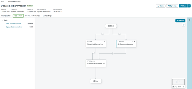

-> Using the SubFlow In Now Assist Skill Kit

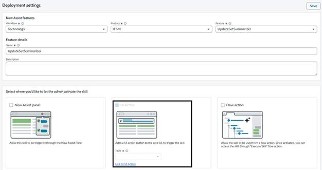

Step 4 - Deployment & Skill Settings

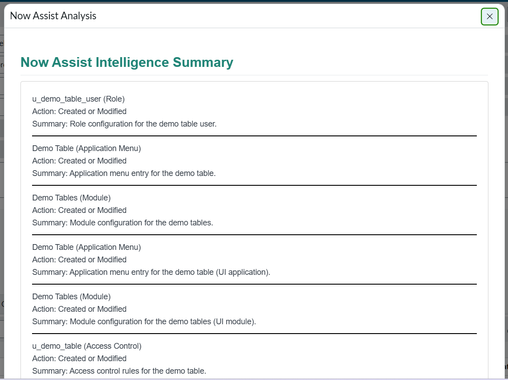

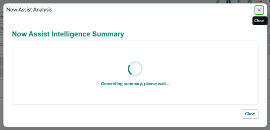

Step 5: Frontend Implementation (UI Action & UI Page)
This all I had deployed as UI ACTION on UPDATE SET (sys_update_set) table using the UI PAGE
which basically displays the Structured response given by now assist.
