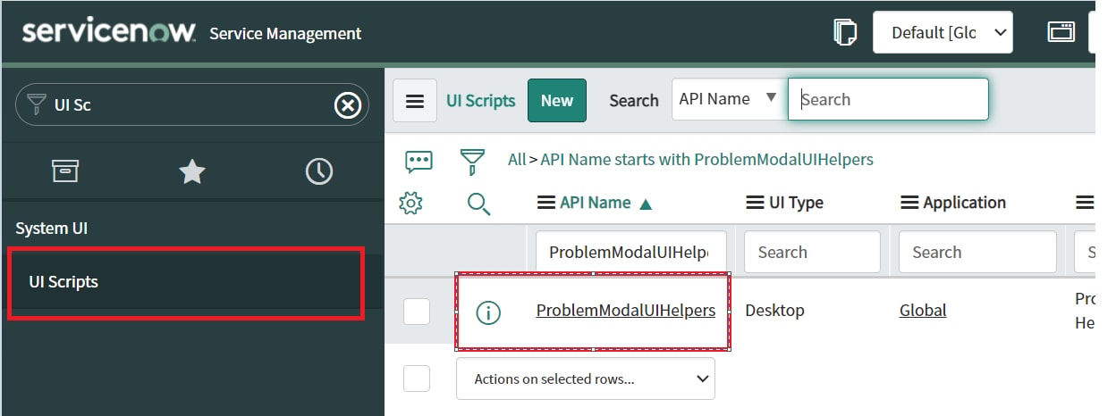

The way it works OOB is mentioned below:
1) For example when you click on "Assess" button, a popup/modal is displayed for which within the UI action ServiceNow OOB calls a UI Script named as "ProblemModalUIHelpers" as shown below as well where all the functions for different buttons are written.
For example, for Assess button below is the function which gets executed "ProblemModalUIHelpers.onAssess" as shown below:
Navigate to UI Script module and search for Name as "ProblemModalUIHelpers"
My suggestion would be do not customize this OOB UI Script component as there can be impacts(might get skipped and you may miss some important updates) when you upgrade to higher version.
If you need exactly similar thing create a new UI Script and use the same approach as ServiceNow OOB is doing . Refer to one of the actions highlighted above.
