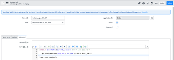

Hi @Community Alums ,
you can use before create or update business rule on sc_req_item table and give condition as Item as your catalog item(Item is reference field available on RITM table).
use
current.variables.start_date //you can get catalog variable values like this and set values using before update or create Business rule
If it helps please click Accept as Solution/hit the Thumb Icon.
