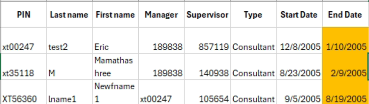

I have a requirement for onbefore transform script which is working partially-
Condition is
If Manager (u_manager : source) starts with 'xt' OR 'XT' & Manager (manager : target-sys_user table) then ignore the insert/update of those records in target table.

})(source, map, log, target);But after loading the below excel sheet data

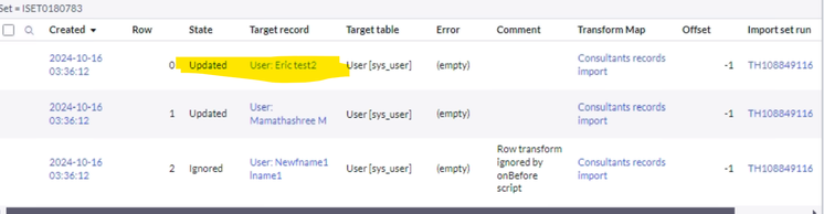

it gives below results for Imported Set rows Insert/Update/Ignored-
Since in the target user table, for the user 'Eric test2' record, the Manager field is NOT EMPTY, so as per the transform script condition part (targetMgr != "") it should 'Ignore' the updation of 'Eric test2' record, but as shown in above screenshot we can see yellow highlighted record of 'Eric test2' is updated which is not expected, it should be 'Ignored'.
Please note I have tested other condition (source manager contains XT or xt) and that is working fine but don't know what happen if I added targetMgr != "" condition.
Please help to modify the script so that it will work.

Hi @rishabh31
Try below Script
var sourceMgr = source.getValue('u_manager');
var targetMgr = target.getValue('manager');
var isSourceMgrInvalid = (sourceMgr.startsWith('xt') || sourceMgr.startsWith('XT'));
var isTargetMgrNotEmpty = (targetMgr !== "");
if (isSourceMgrInvalid && isTargetMgrNotEmpty) {
ignore = true;
} else {
ignore = false;
Esh
