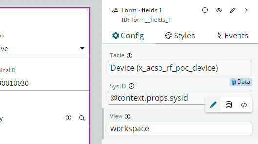

OK one more time with this issue, maybe someone can explain what I'm not getting.
I'm working on a proof of concept in UI Builder, and opening up a record from a click event. My table does not extend Task. When I wire up the click event in my list to open the selected record, I get
 This form has not been configured for Workspace. To edit the form, select a different type of record, or contact your administrator.
Of course many people have asked about this, and many others have replied, so let me take this example of a reply (clearer than most), and the steps I took to carry out its instructions..
I go to System UI | Views.
I open the workspace record (I created this earlier).
I click on New under the Forms tab and add a row representing my form.
Then I open a record from my table and choose Configure | Form Layout.
I confirm that my table has a Workspace view.
But when I open UI Builder and open my record, I get the same message.
So what is it I did not do, or did incorrectly?
thomaskennedy
Here is the solution: If you put a Form - fields component on the destination Page, you have to fill in the View field. The default value is ess.
