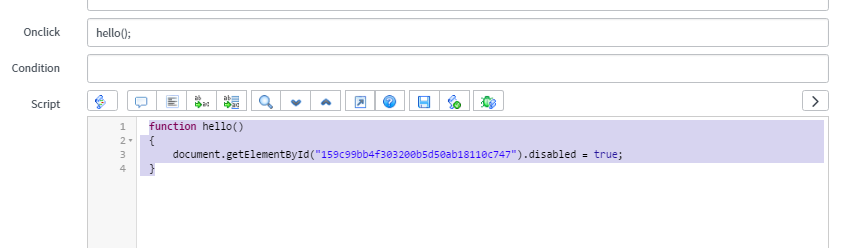

Though not recommended, this requirement is possible with DOM manipulation.
Get the id of your button by inspection the element through F12 (browser developer tools)
On the UI action check the client checkbox and mention an onclick function.
Use the below script in the body. Also use a try/catch statements while using DOM manipulation
function hello()
  document.getElementById("159c99bb4f303200b5d50ab18110c747").disabled = true;
Please hit LIKE or mark HELPFUL if found appropriate
