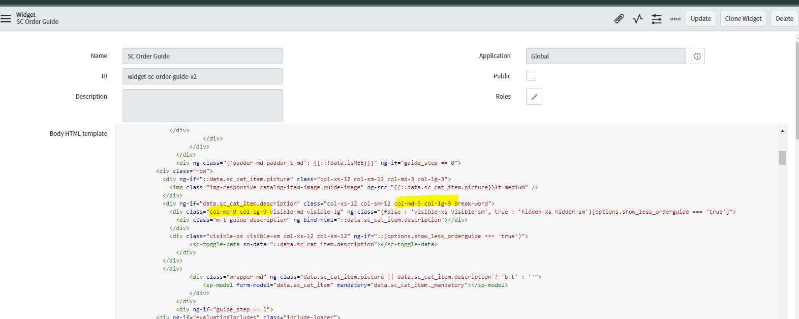

Wondering if someone can assist me in fixing the below issue. For whatever reason, no matter what adjustments I make in the HTML editor, the description will not span the entire description window. I have tried adjusting the margin in the editor as well. Is there a way this can be changed, please view the screenshot and kindly let me know. Thank you.

Did a few different searches before and after posting, and as luck has it I usually find the answer after posting. So I will update my question with an answer. Changing the class config from 9 to 12 allowed the text to stretch, and found out that this will impact any order guides with a picture so be careful when adjusting these.
The link below solved this for me
https://community.servicenow.com/community?id=community_question&sys_id=3893b2cddb0b1094190b1ea668961972
