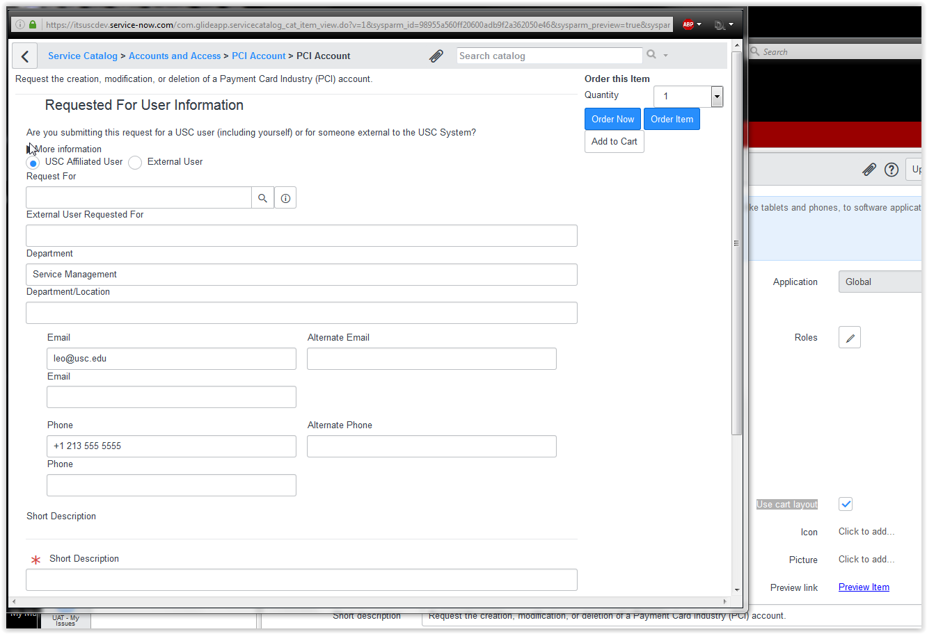

We recently upgraded to Geneva (patch 6) and noticed that the "order now" button for our catalog items was gone.   After searching the community boards I found a discussion that suggests altering the form layout and adding the "use cart layout" checkbox.   After making the change, the "order now" button returned, but it does not work and an added button called "add to cart" is also displayed
So my questions are:
  1. Is this the correct approach to getting the "order now" button back....and if so
    1. How do I get the button to order and redirect to the order details page?
    2. How do I remove the "add a cart" button
  2. Is there a way to move the button to the bottom of the form?
- Leo

Hi Danny,
Thank you for your suggestions, but the 'order now' is still missing.
As I mentioned earlier, the 'order now' button reappears only after I alter the form layout and add "use cart layout".     When I select "use cart layout" (in form layout), the button reappears (along with others), but none of the buttons function or redirect to the 'order status' screen'.
By modifying the "Item Ordering Widget", I can remove the extra buttons, but I'm still wondering if this is the correct approach.   There is also the issue with functionality and button location (see questions in my original post).
