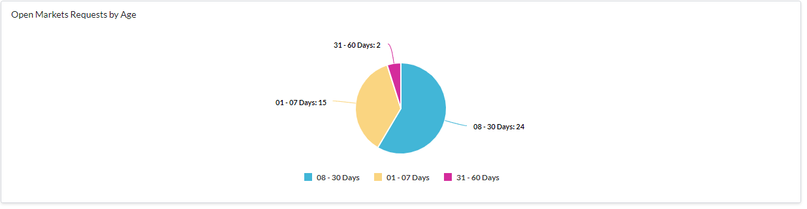

I've got the following PA Pie Chart on a dashboard:
However, what I've realised is that if I create or close any requests, the numbers on this PA Pie chart do not follow even though the related indicator has the following setting:

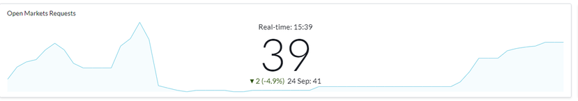

I've got another PA Real Time Score widget that is showing the correct scores of 39 requests:
I was just wondering if somebody knew why the PA Pie Chart won't follow the data on the related table in real time like my PA Real Time Score widget

Hi @AndersBGS Thanks for the update. So because I'm using a pie chart, it won't give real time scores?
Hi @matthew_hughes ,
Yep, if you change the visualization to a Single-score without any other changes, then it should work as intended.
