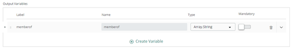

Then I set my output as an array string and was able to use it within the For Each.

You will notice that I removed all the other elements and I am only outputting an array of strings. I deleted the output and updated it accordingly.
Outputs
I deleted the outputs and created just one called membership which is nothing more than the array from Post Processing & Error Handling.
You will need to update the parsing code to handle what you need to strip out. For me I just needed the CN piece so I updated the code to strip that element out only and it also strips off CN= so that I just get the group names. Attached the xml as well
