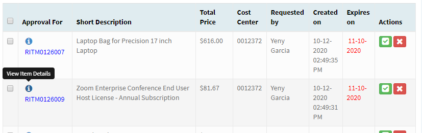

Thank you Justin and @Tony DiRienzo for you help on this. I got it working to display the RITMs variables in the modal.
This is how the table looks - still have to adjust some things here and there like the (i) that displays the modal, I want it to be next to the number instead of above but that's all CSS stuff.
Thank you both for your help on this!
