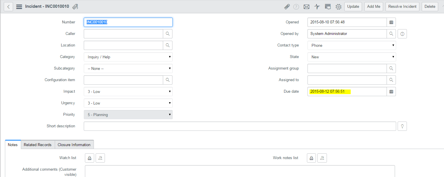

The business rule:   onBefore insert or update
The incident created:
The sys_trigger automatically created from the business rule:
