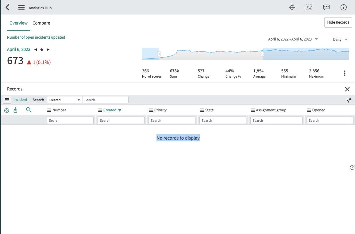

performance analytics

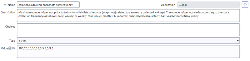

According to the historical data collection job you have ran, where you have tried to capture data prior to the 7th of august 2023, have you then looked in the logs of the data collection? If there are some warnings like this "Snapshot within this range is older than the maximum age, based on the indicator frequency and snapshot periods":
This is caused by: https://support.servicenow.com/kb?id=kb_article_view&sysparm_article=KB0746184
Where if you look in the sys_propeties.list and search as mentioned above, you will see:
best regards
Anders

Hi @Shailja Sharma1 ,
What have you updated the properties to? What do you mean by both?
best regards
Anders
02-07-2024 11:53 PM
As there are two options have been mentioned to fix the issue.
com.snc.pa.dc.keep_snapshots_for.frequency and com.snc.pa.dc.keep_scores_for.frequency but still not working as expected.
