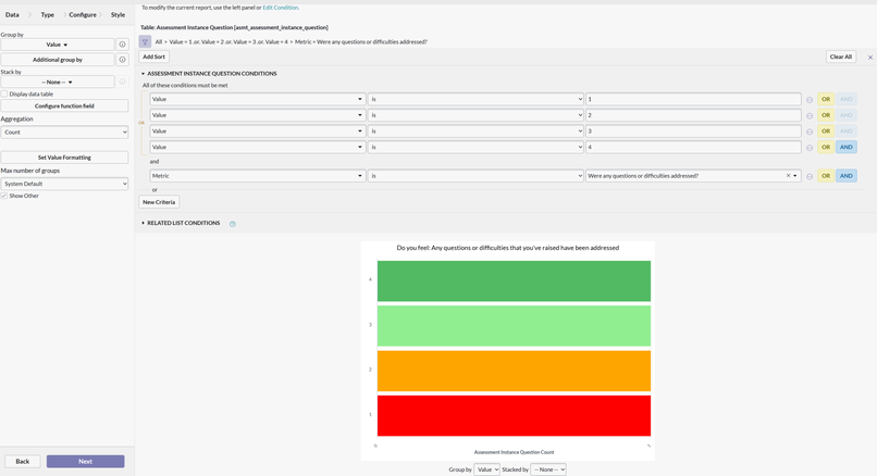

After migrating a dashboard to platform analytics, all bar charts are not displaying any data despite being configured the same.
We have tried various group by values, sort by values and aggregations.
When configuring different group by values and going into the list view of the chart, the correct data is being shown.
Any help or advice would be appreciated,
Thank you.

Have you looked at the data source instead of the visualization? It seems like the data source is broken somewhere.

What happens if you create a fresh bar chart in Platform Analytics with the same table (asmt_assessment_instance_question), same filter, and same COUNT.
If it works, the migrated widget’s field mapping is stale and needs re-selection.
- Jan
This hasn't worked unfortunately
