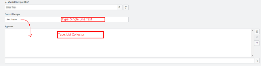

Could someone please help on setting List Collector Default Value based on other text field?

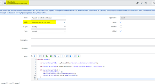

When form load, we need the populate the List Collector with the value in Current Manger field.

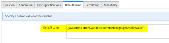

Here is my currently configure, but this did not work.  Thank you

Thank you for helping @Riya Verma
I forgot to mention in the thread those are variable fields.
I must have done some wrong in order to make it not working.
Here is the screenshot:
