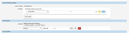

You can add a condition to your Read Row Level ACL like this, replace Number with your Company Code field:
Because you are applying it at the Row Level, you won't need to redo your specific field-level ACLs.
