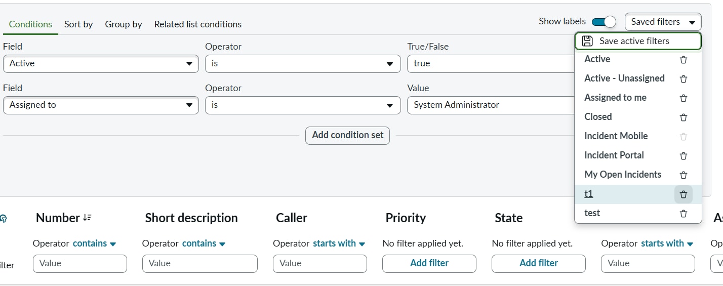

I have a requirement where users should be able to delete their saved filters directly within the  FSO Workspace interface.
I reviewed the delete ACLs for the sys_filter table and found that three table-level ACLs are present, but they are out-of-the-box (OOB) configurations.
Interestingly, I can see the delete option available in the PDI for the Service Operations Workspace (with those 3 OOB ACL's). I would like to enable a similar delete option in the FSO Workspace as well (right now no delete option visible for admin access).
Please let me know if anyone has implemented this or can guide me on how to achieve it.
