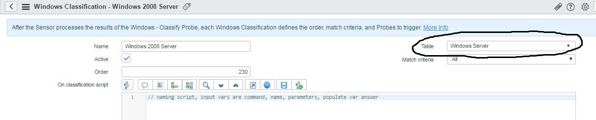

The client is adamant on populating discovery data in a staging table, and then promote it to the golden data set (CMDB), despite this not being standard practice.
As suggested by you, I looked into the discovery_classy table. Would simply changing the corresponding table to the custom table (as shown below in screenshot) for each of the classifiers be enough to populate the custom table with the data for the respective classifier? Or will I have to modify probes/sensors as well?
Supratik
Yes, it should work but I never tried it personally. Don't create entirely a new table with custom field names, that will confuse the sensor to update the fields. Suppose for Windows classification extend your existing windows table so that all the field names will be same but still your sensors will work.
