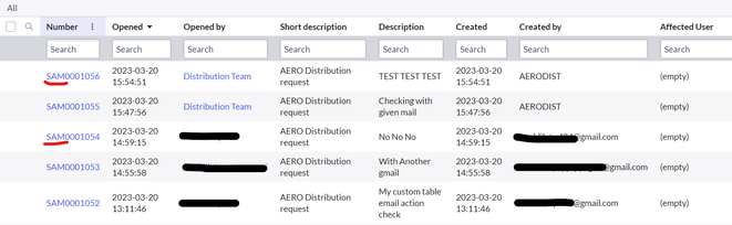

03-21-2023 02:06 AM
Hello @Weird ,
Tried with give line adding in Inbound actions, it is creating ticket with give prefix via email action.
And to tried to a ticket through the system the prefix not changing. So can able to filter the tickets with prefix in the table.
Can see below Image.
Thank you.
