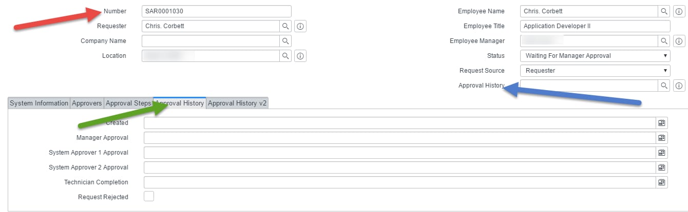

I know this is possible but I'm drawing a complete blank. I'm trying to establish a reference field link between two tables so that data from one
table can be displayed on the other. I'm trying to configure it so that the reference field is populating on its own without needing to manually
type anything in.
Here's my set up
Number is my autonumbered record. Approval History is a reference to a second table where I store the Number plus the fields I have showing under the green arrow.
The structure of that table is like this:
I am trying to populate the Approval History field to prepopulate so the field information shows on its own.
