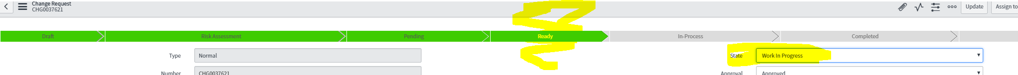

So I needed the Process Flow formatter to show a Flow Formatter dynamically and since some of the java code was not available I updated the UI Macro "process_flow" to do what I needed. Including it all here for those who mite be interested in such an enhancement.
Add the field "u_view_condition" with a type of "conditions" to the sys_process_flow table.
Here is the new code for the UI Macro "process_flow"

DrewW
For those of you how would like to use the updated version that I put on ServiceNow Share with out having to load the update set here is the updated UI Macro code.

DrewW
All, as far as I can tell this works but the styles are off in Fuji.   Fuji also updated the formatter look all together.   I'm looking at needed changes for this to work using the new format in Fuji.   When I get done I will post it to share.
DrewW
For those who are interested this has been updated over on the share site.
