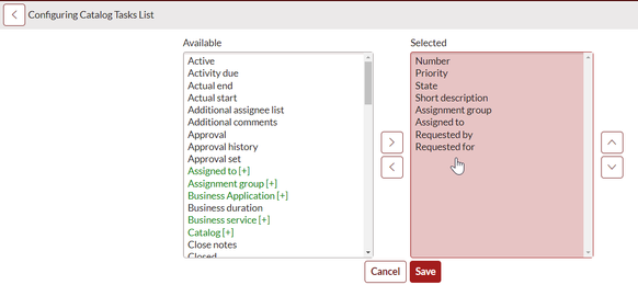

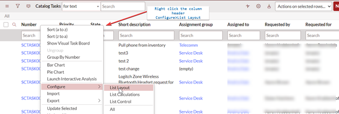

Step 5 Head over to the list where variables were just added. They won't show up immediately, so don't panic. Edit
the list layout, and move around the variables to the spots you'd like them in the list (even if the position is already how you'd like it, move a variable one position up/down, then move it back and save). At this point, the variables should be visible!
