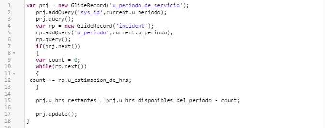

Hi   dvp,
I've been doing some tests and found a problem, I tried to fix it but even I don't get it, Could you help me?
I explained the problem below:
I have two incidents, these incidents have "estimated hours" each.
The code make that the value of "u_estimacion_de_hrs", and bring it to the subtract with "u_hrs_disponibles_del_periodo" and put it in the variable "u_hrs_restantes"
this is the script:
  • var prj = new GlideRecord('u_periodo_de_servicio');
  • prj.addQuery('sys_id', current.u_periodo_de_servicio);
  • prj.query();
  • while(prj.next()){
  • var rp = new GlideRecord('incident');
  • rp.addQuery('u_periodo', current.u_periodo_de_servicio);
  • rp.query();
  •   var count = 0;
  • while(rp.next()){
  •   count += rp.u_estimacion_de_hrs   ;
  • prj.u_hrs_restantes = prj.u_hrs_disponibles_del_periodo - count ;
  • prj.update();
The problem is the following:
I have the incident number INC0013727 in this contract   "contrato 1", but when the script is run
the variable "count" is equal to "18" because it's the sum of the two incidents mentioned above, because they have a value assigned to each, in the variable estimated hours., The problem is that should not make the sum so, You should only add the incident or incidents that relate at the time.
You should only add the incident or incidents that relate at the time and that appear in the list of each contract separately, not as now the operation is carried out.
In the example should only appear to have been used 9 hrs.
could you help me please.
Thanks for advance.
can you tell us on which table the business rule is written?
also are INC 13727 and 13725 both related to contracto 1 at some point or no??
