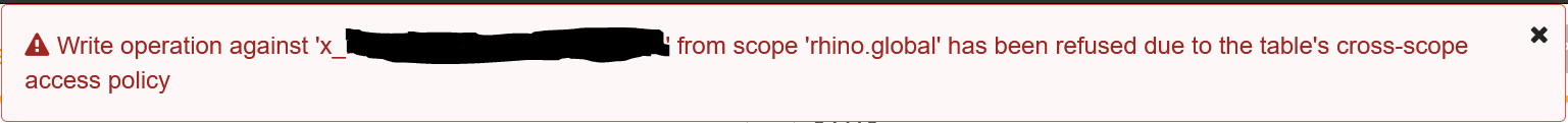

Recently I've been working on adding Activity Streams to our Scoped Application's Service Portal, and though I have been able to add activity streams to all relevant tables whether extended from Task or not, I am getting the following error when I try to post Work Notes or Additional Comments to the Activity Stream.
I have double checked that the tables in question have the correct Application Access. Here's a screenshot of how they look.
I also added a Restricted Access Privilege record and a Cross-scope privilege record in hopes that they'd help, but they did not.

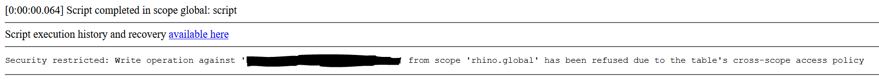

According to multiple community posts this configuration should be correct, but it's still giving me the same error. In fact, when I try to write to our Scoped App's tables from the Global scope using the Scripts Background, I get the same error.
Has anyone encountered this error? Hopefully I just missed something or other. Thanks everyone!
