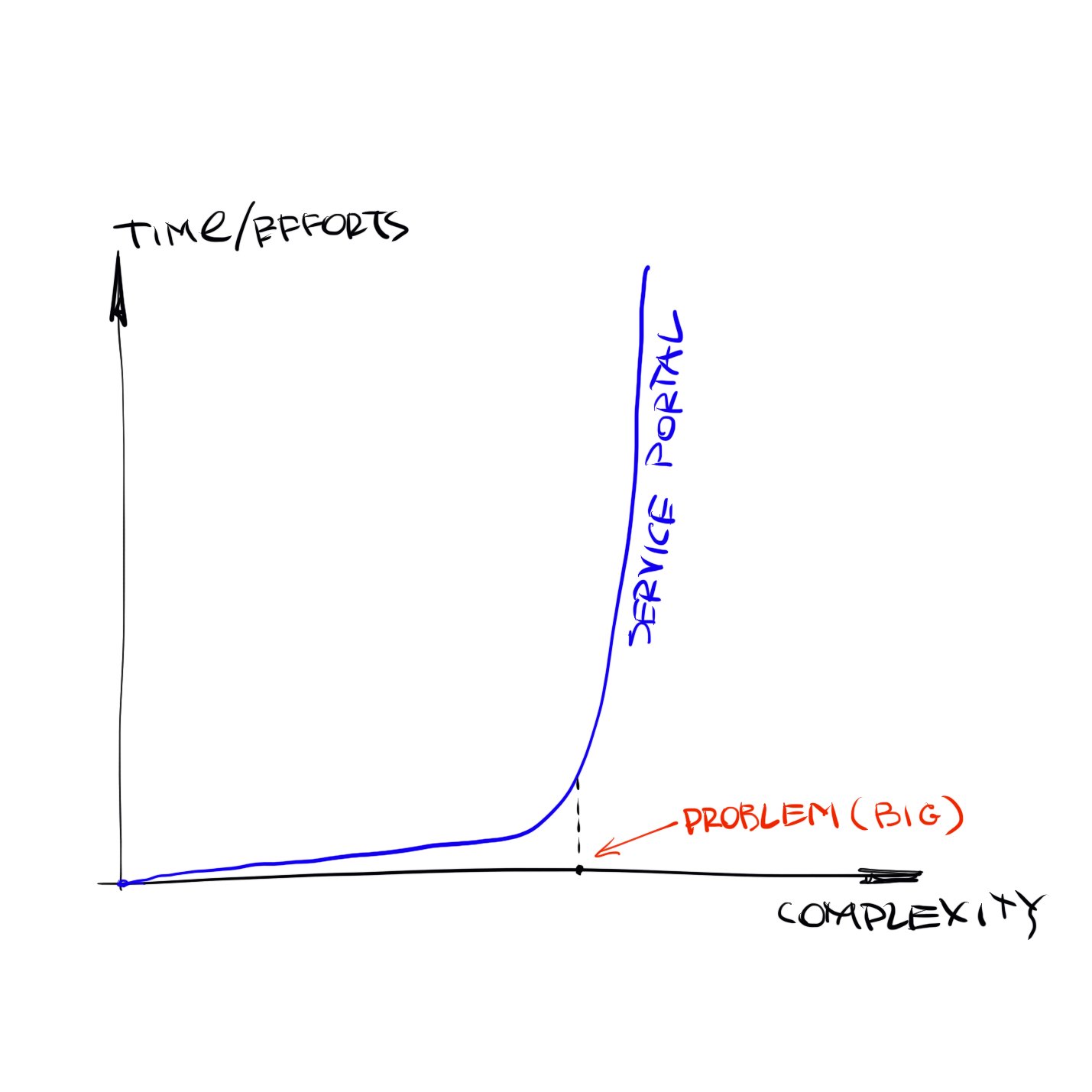

You're absolutely correct, it's already there. We definitely can use modern web frameworks in ServiceNow. It's just almost every day I see how people are struggling with Service Portal because of proprietary API, angularjs, IDE etc.
Service Portal works fantastic for simple tasks with minimal configuration, but some advanced functionality makes things exponentially complicated in Service Portal.
