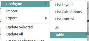

10-28-2016 06:38 PM
Hi Glenn,
The getDisplayValue() function will return the column label of the field that has been set as Display = true in the dictionary entries on the referenced table.
This will normally be set out of the box for ServiceNow tables but you have to set it yourself if/when you create a custom table.
Do this;
1. Open the table you are referencing in "configuration mode"
Look at the Display value column and set the value to true for the column label you would like to be used as the value to appear in the reference field;
