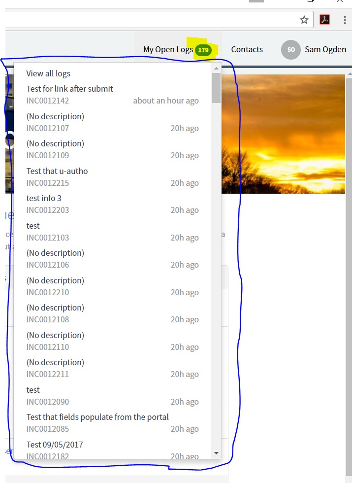

Thanks for the above, that's worked great. I do have one other issue that I'm wondering if you could help me with. I want the counter that is shown in the menu (highlighted in yellow below) to still show the total number of logs, but I would like the list (circled in blue below) to only show the first 10 incidents and the first 10 requests (20 in total).
Below is the current code for the scripted list. If I change the var 'max' then it changes both the number of logs displayed in the list, but also the number shown in the counter. Do you know how I can change this to work for the above requirement?
Any help is greatly appreciated.
