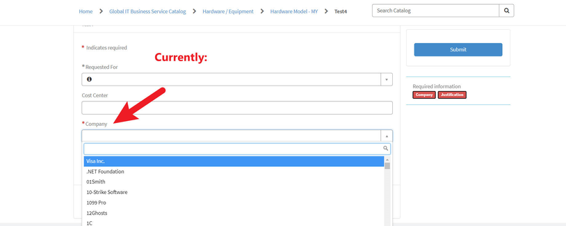

2. One of the variables is "Company" and I would like to put in a filter so that only Company starting with alphabet "A" will show up in the drop down.

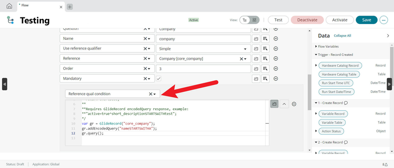

3. I am not sure how to do the scripting for the variable in the "Reference qual condition" field. Appreciate your help on this!

Hello @Community Alums ,
you can try this script
var gr = new GlideRecord('core_company');
gr.addEncodedQuery('nameSTARTSWITHA');
gr.query();
return gr.getEncodedQuery();
Hope this helps
