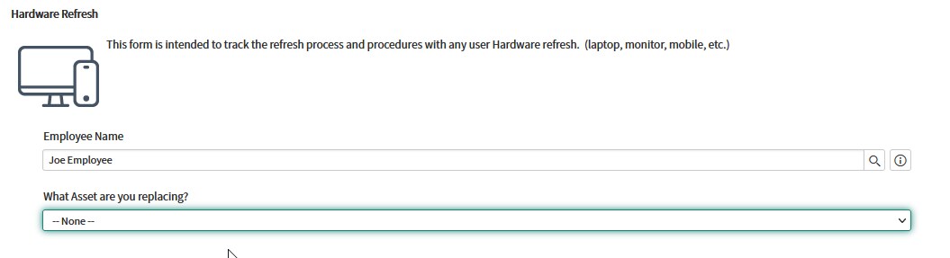

Digging this one up from awhile ago.  I'm trying to achieve something similar.  Looking to produce a simple form for a hardware refresh.
I want variable #2 to show me the assets assigned to the employee from Variable 1.
Here is my screenshot of the form.
Based on the accepted solution, I tried to replicate it, but getting Null as the result.
Chris, looks like you're trying to populate the second variable based on the first on your catalog item. I am assuming the 'Employee Name' variable is a reference field, where the selected value will be a sys_id.
If the pictured variable refers to alm_hardware table, to correctly query that table (independent of the catalog item element) would look like this:
Assigned to = Joe Employee
This would give you an encoded query of something like
assigned_to=0e792b381451055044a3dc06b04bcbb5
What you are trying to accomplish with the Reference qualifier field is to apply this filter in a dynamic way, incorporating the other variable.
Let's break down the parts of that req qual field...
javascript:
This is included to tell ServiceNow we want to evaluate this (not a static value)
'assigned_to='
This is the static part of the query
+ current.variables.employee_name;
This is the dynamic part, where you reference the variable. The last part of it needs to match the NAME of the prior variable, as well as the TYPE. If the variable has a value of "Joe Employee" instead of the sys_id, you would need to change the static part of this to 'assigned_to.name=' to match the data value.
Putting this together (and what should be in your reference qualifier field):
javascript: 'assigned_to='+current.variables.employee_name;
