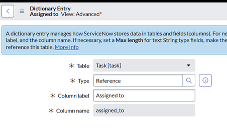

I have an issue with filtering inactive users on a reference field on a form.

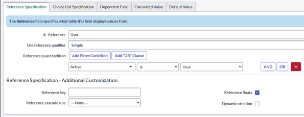

and the reference specification details:

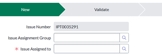

however on the Issue form, the Issue assigned to field would still show inactive users

Is there any dictionary override applied in the IPT table? Can u give me the table name to check in my Pdi?
Issue table: sn_grc_issue

This field as dictionary override
You need to update the details here not in task table.
PoojashreeP
HI @dev_K ,
Is assigned to from task table and Issue Assigned to both are same fields?
You have added reference qualifier to assigned to on task table. Similarly add the reference qualifier to Issue Assigned to field also in sn_grc_issue table. As both are different fields. Also check for dictionary override for this field.
