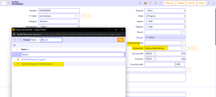

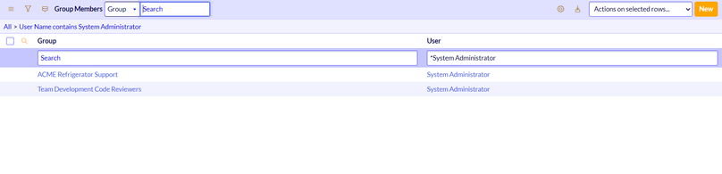

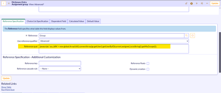

This can be done without any scripting just by adding below reference qualifier and I have tested the same and its working exactly as per the requirement, so please let me know you views on this.
javascript: 'sys_idIN' + new global.ArrayUtil().convertArray(gs.getUser().getUserByID(current.assigned_to.toString()).getMyGroups());
Please Mark Correct if this solves your query and also mark 👍Helpful if you find my response worthy based on the impact.
Thanks & Regards,
Aniket.
Hello @AniketC85155510
Your low-code approach is commendable; however, it falls short of meeting the requirements. If I do not select "assigned to" it displays an empty group list which should not occur. If "assigned to" is empty, I expect to see all the groups. Thank you.
