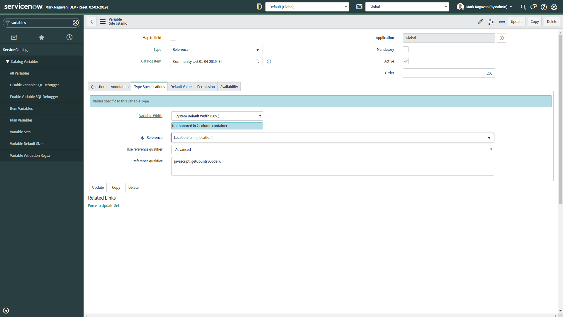

ā04-01-2019 03:14 AM
Hi there,
Because the dotwalking on the variable won't be possible, you would have to use a Script Include. Not that hard to setup, just tested the below scripting, works instantly.
Though, as I already mentioned, because the Country field on Location is a String, this could be very tricky. Already with testing out of the box, I'm encountering stupid differences. For example, United States of America being USA (matches country ISO Long, Australia being... Australia instead of AUS (doesn't match country ISO Long).

ā04-01-2019 01:59 AM
Hi there,
Have you tried applying an advanced reference qualifier on "Site list"? I don't know your exact variable names, so here's an example of what you could do.
I also noticed your using "ref_qual_elements = core_country.iso3166_2;". Within this code, I'm missing the variables part? (you are talking about a record producer right?)
Have a look at especially the javascript and variables part.

ā04-01-2019 02:34 AM
Hi Mark.
An advanced reference qualifier is exactly what I am trying - I am not able to come up with a solution in regards to that picture. It is a Record Producer indeed, core_country.iso3166_2 is the Country Shortcode of the core_country list, so yeah, current.variables.core_country.iso3166_2 I assume it would be.
Maybe with below info you'll have a better shot?
Country list info:
- Type: Lookup Select Box
- Lookup from table: Country [core_country]
- Lookup Value field: Name (OBS! This is the full name of the country, not the ISO Short which is the country code)
- No reference qualifier
Site list info:
- Type: Reference
- Reference: Location [cmn_location]
- Use reference qualifier: Advanced
ā04-01-2019 02:42 AM
Hi there,
