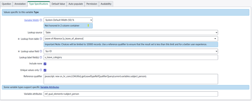

@Ankur Bawiskar Here is my leave_type variable configuration:

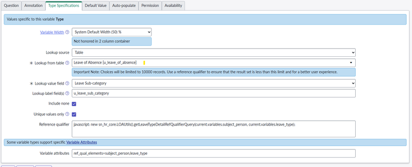

Here is my leave_type_detail variable configuration

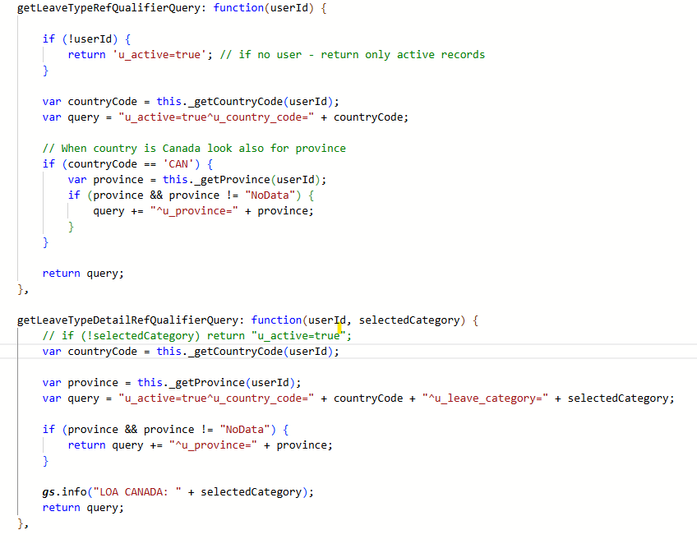

And I'm using script includes to build a query for reference qualifier.
the u_leave_of_absence table has fields u_leave_category and u_leave_subcategory.

did you add log and see if value is coming in script include function?
