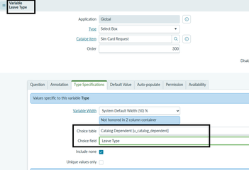

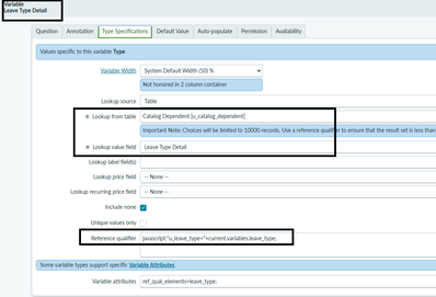

Hello @Martines ,
These can be achieved by simple lookup select box configuration fetching values from custom table :
First create one variable (Select Box) name Leave Type and setting as follows:
One Variable (Lookup Select Box) name Leave Type Detail and setting as follows:
Then in one custom table add two of your fields (choice) - leave type and detail and values as follows :
Then you will get the result as per your requirement :
08-14-2026 05:52 AM
Thank you for your response.
I cannot have type select box for leave_type variable, because I need to put there reference qualifier for that field.
