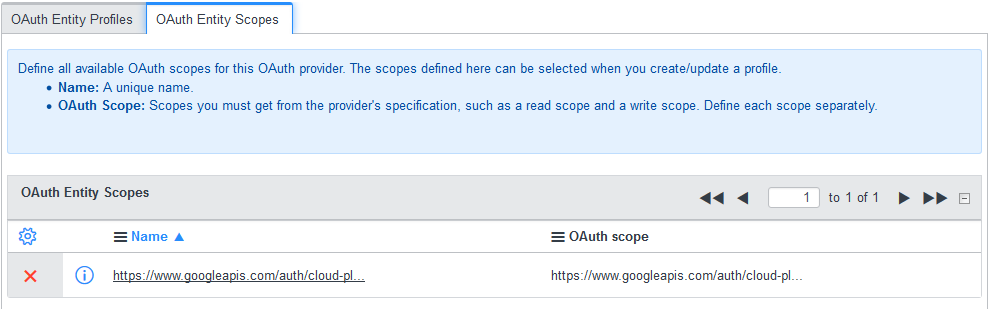

First, I have created a OAuth Profile for Google Cloud in the Application Registry using the 'Connect to a third party OAuth Profile'. The Profile created is as follows.
I am using the OAuth Profile in the REST Messages to Various Calls such as Create VM,Turn Off Vm,Turn On VM etc., when I am using the OAuth Profile it shows the following message every time that 'OAuth Access or Refresh tokens are not available. Verify the OAuth configuration and click the 'Get OAuth Token' link below to request a new token.'
Everytime I query a REST message it shows this and I need to Click on Get OAuth Token to get the Token. The Validity of the token lasts for only an hour after that I need to refresh it again by clicking on the Get OAuth Token.
I need to know is there any way by Scripting or any other method to get the OAuth Token without Clicking the Get OAuth Token and also token lasts for a longer time.
