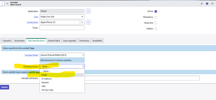

BTW, if you need to validate email on a catalog item, use Validation Regex on variable as seen below:
Sharad

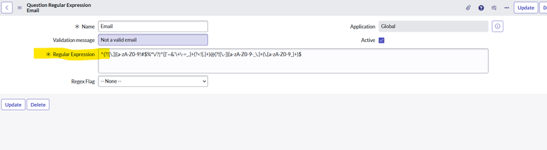

You can find many regular expressions for email validation. However, you can try using an out-of-the-box (OOTB) regular expression.
SS - 1
SS - 2 : In the marked field, you can use your regex for email validation.
If this solution resolves your query, kindly mark it as the accepted solution and give it a thumbs up.
