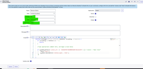

Subhashis Ratna
Hi @Prasnajeet1
For me it's working . could u please retry and let me know .
Scenario : When Caller is "Abel Tuter" then Remove "Chat" Option from Channel.
      return;
   if (g_form.getValue('caller_id') == '62826bf03710200044e0bfc8bcbe5df1') { // Caller = "Abel Tuter"
        alert('test');
        g_form.removeOption('contact_type', 'chat');
 CS :

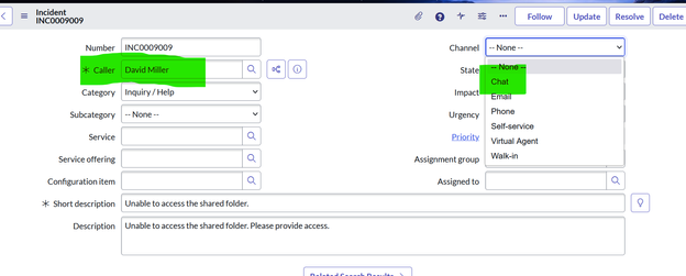

O/P :
Now You can see the Caller is "David Milller" and Channel has same "Chat" option.
after Caller changes to "Abel Tuter" , "Chat" option is not available in Channel.
Note : If you are trying to remove a specific choice value from a variable , then kindly go through these links :
Link 1 : https://www.servicenow.com/community/developer-forum/g-form-removeoption-is-not-working-on-the-varia...
Link 2 : https://support.servicenow.com/kb?id=kb_article_view&sysparm_article=KB0678206
Please mark this comment as Correct Answer/Helpful if it helped you.
Subhashis
