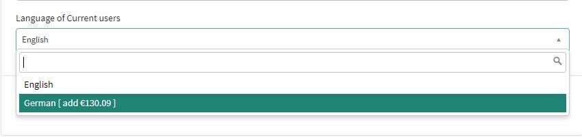

I am looking to remove the price implication value from the select box variable's question choices label.It should just have the same label mention in question choice form not with the suffix of [add $1XX] or [subtract $1XX].
I have set the "glide.sc.enhance.labels"  to "false".But ,Still I am facing this issue with the Select Box Varaible's question choices labels.Attaching screenshots for reference.

Go to your variable, and in question choices set the price to 0$ for all your records

I'm having the same issue here. Even though the system property (glide.sc.enhance.labels) is set to false the enhanced labels still appears for Multiple Choice and Select Box variables type. However, it does not appear for Checkbox type.
