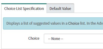

I created an app extended from task table. I reused short description field. Is there a way to hide the suggestion button that appear next to short description for this table? It is not needed and would possibly cause confusion for the users. I'm hoping there is a way to do this without DOM Manipulation. I was able to remove knowledge by overwintering the variable attribute but I did not see anything for suggestion in the variable attributes.
