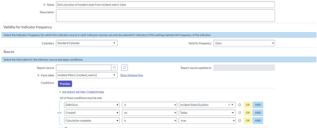

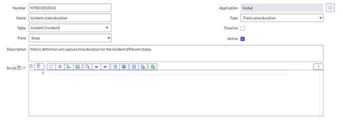

Sure, no problem. What you need to create something usable is:
1. The incident_metric defintion to capture duration
2. An indicator source

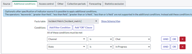

3. An automated indicator (unit can be set to seconds, minutes or hours according to your preferences).
There should be created one automated indicator pr. channel and pr state, as you will like to separate channels from each other
4. A scheduled job to collect data
5. A widget to visualize the data - this is really depended on your choice, so I haven't created a moc up.
