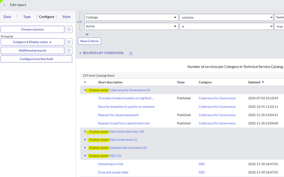

I want to report on catalog items by category but then stack them by all items in that specific category. Is it possible?
I attach a few screenshots to better explain.

I tried this, in graph it is not possible what you looking like
Category -- Name
But in list view report , we do group by name and category.
You can sort as well if required.

Yes this report can be build up, so what i understood from the images
- There is catalog item - Technical Servcies
- and under that you have different variables like DB2
In image 4, try to add the stack by Category also.
Or I am missing some thing wrong on requirments.
Thanks AJ
It is a little bit different. The Catalog is Technical catalog. Under the catalog I have various categories which are displayed in the graph. What I want to do is stack the different services within each category.
So I am already grouping my report by category, I need to know if there is a way to stack by name of service under each category. If you look at the 'Reporting6' screenshot 'DB2' is a category under the Technical Catalog. Everything below (in the 'Name' column) should be stacked on the report under DB2.
Category -- Name
AJ just one more question please. If you look at my Reporting7 screenshot that I just attached, is it possible to take out the word 'Display name' (I suppose it is the column name) in front?
