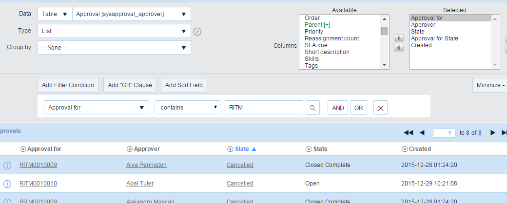

I have a Request item with approvers in the Workflow.   I want to report on who approved/rejected each step.   I tried from the Approval (sysapproval_approver table) but can't find how to dot walk to the item.   Is this possible?   ~Thanks.

Yes, you can add assignment group as well. Dot walk can be done for a reference field, if you select refernce field like "Approval for" in the available section you will find   "+" symbol beside to the available section. Just click on that '+' symbol to get that specific table fields.

Raju Koyagura
Create report like below, I am not sure is the same thing you are looking for....
Perfect!   Thanks.   Each approval has a group assigned to it.   The last field I need is this group.   Is this possible?   Also, is there a way to see table relationships to help me with the dot walking?   Thanks   for your help.

Hi Sherri,
You can try with the report Raju mentioned above. If you want to get the complete details of approvals for a single request item then give the filter as Approval for is <RITM number>.
