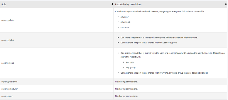

Hi @Deepanshi1 ,
It is all about the sharing of the report together with what report role the viewer has. Please see this product documentation: https://docs.servicenow.com/bundle/vancouver-now-intelligence/page/use/reporting/task/t_ShareASettin...

Reports can be shared on group level. Just click 'share' and share it with the group(s) you need to share it with.
