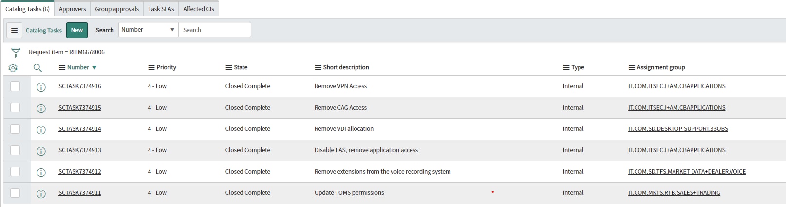

I have a Requested item (RITM) that consists of 6 catalogue tasks. When the RITM is first raised, the Stage is set to 'Fulfilment' and the 6 catalogue tasks appear. When the 6 catalogue tasks are completed, I would expect the Stage of the RITM to be set to Complete. However, at the moment, the RITM remains in the state of 'Fulfilment' even though the catalogue tasks are completed:

I'm confused because in the screenshot, all of the catalogue tasks are set to complete.
