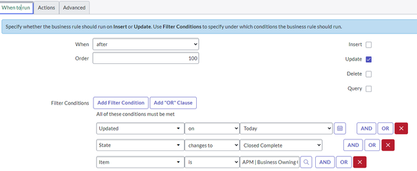

I'm trying to setup a notification for when a certain catalogue item is completed. The catalogue item contains a list of business application that a user chooses to update. I've created a business rule that triggers the event:

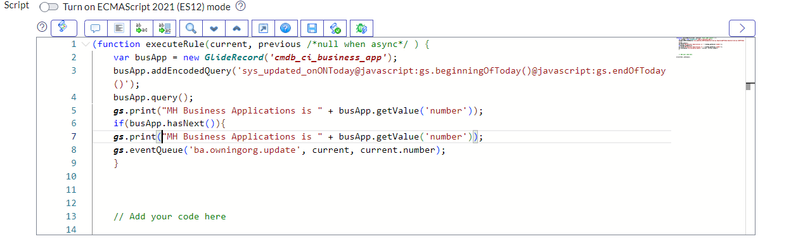

I'm trying to use the following code to find any business applications that had been updated at the same time:
However, what I find is that nothing is being returned in the logs even though a business application has been updated through the catalogue item.

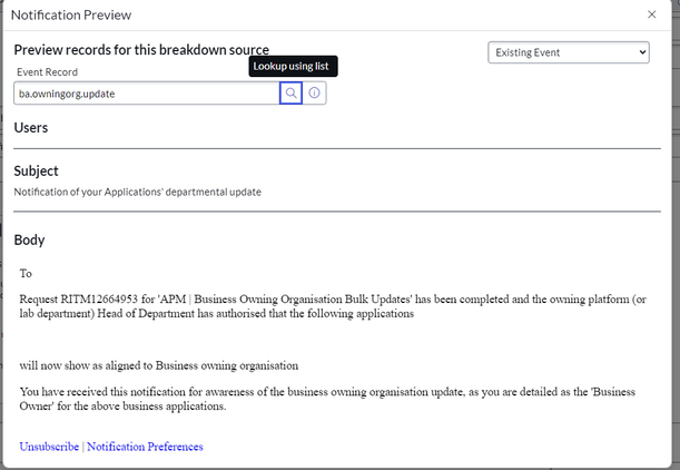

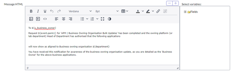

My email notification is using the Business Application table:
What I'm finding is that the ${u_business_owner} and ${department} fields are not getting updated:

First, you don't need the "Updated on today" condition. The business rule runs when it's updated, so that's redundant.
Next, your business rule is running on the RITM (sc_req_item) table, so that's what's in "current". So if your notification is running on a different table, it won't work, because the event is triggered from the RITM.
Hi @JenniferRah ,
So both the Event and Notifications have to have the same table?
Technically, they don't have to be, but the fields you will see are based on the table that the notification is triggered off of, but the "current" variable is based off of the table the Event is triggered from. You either have to dot-walk to get to where you want to go or change the notification to run off of the same record.

Try updating the script:
gs.eventQueue('ba.owningorg.update', busApp, busApp.number);
Replace current with busApp.
