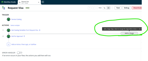

Rohit  Singh
Hi @subashds6515
You need to create stages in Flow designer.
Please refer snip. Once you create the stages in your Flow then it will appear in the RITM for newly created.

Mark Manders
Are you setting the stage in your flow? Stage is just a field that needs to get set on a value to show something. It is not automatically connected to a certain state. It can be, but that will have to be set as well.
